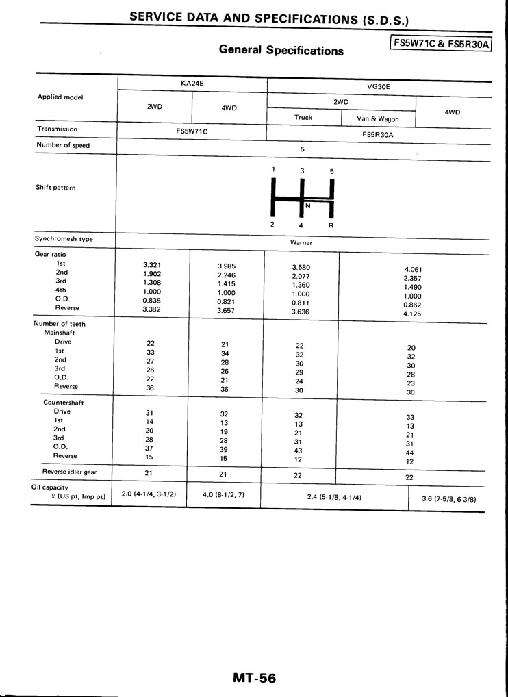

    Here is the page from the 1990 WD21/D21 FSM. As I understand it, all V6 trucks (including pathfinder) from 1990-95 should have the 30A with these ratios. 4cyl was only in the trucks in US and had a 71C behind them.
    Also note, trucks have anywhere from a 3.54 (4 cyl 2wd truck) to a 4.62 (4wd Pathfinder Auto).

      look at the oil capacity !
      for 4wd they add a ton of extra fluid.... they must have seen early failures without it
      it's a safe assumption that using the 4wd capacity is fine for 2wd too, and at least splitting the difference makes sense

                            FYI... the reason Nissan upped the fluid capacity on the 4x4 is to correct the tendancy of oil starvation to the front mainshaft bearings when driving up an incline. However, they didn't FIX the problem. As a 2nd FYI... if you ever get one of these transmissions, you cannot overfill it... pull off the shifter cover from the top of the trans... and dump in an extra qt. of fluid whenever servicing the trans... or use a jack to lift the vehicle from the side severl feet... pour fluid in diagonally sideways through the normal fill-hole to accomplish the same thing. This is something us 4x4 Nissan owners have done for ages.
