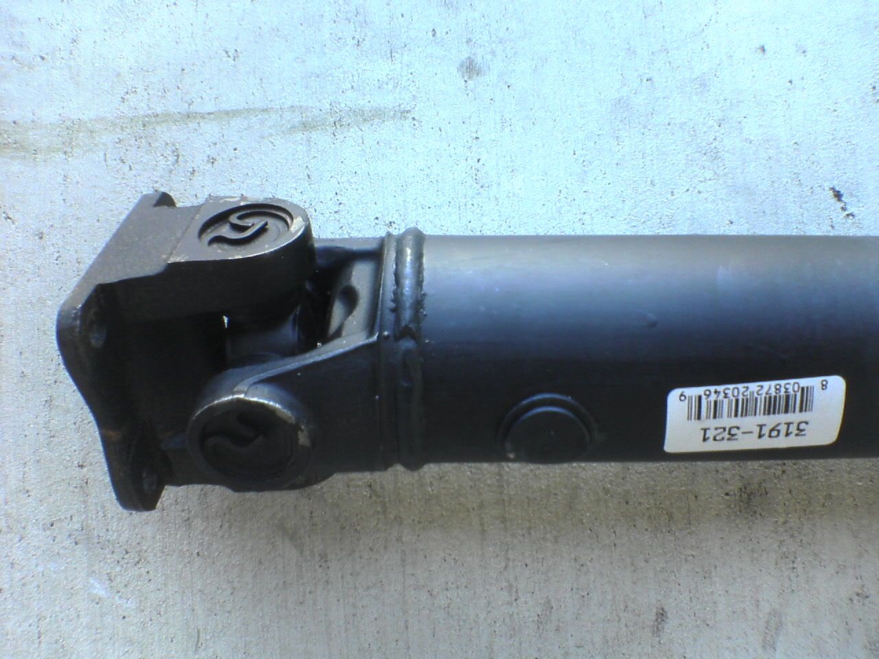

      I've broken my FS5R30A driveshaft twice at the u-joints. I highly reccomend talking to http://www.powertrainindustries.com I picked up my steel unit from them and its quite hefty. Overall weight its probably only 2 pounds heavier or so, but the u-joints are really stout. They're replaceable GM style units.

        What did you pay for your shaft there flawleZ?
        • #5
          roastin300 wrote: What did you pay for your shaft there flawleZ?
          I think it was $330 shipped to my door.
          Sorry for the image size.
