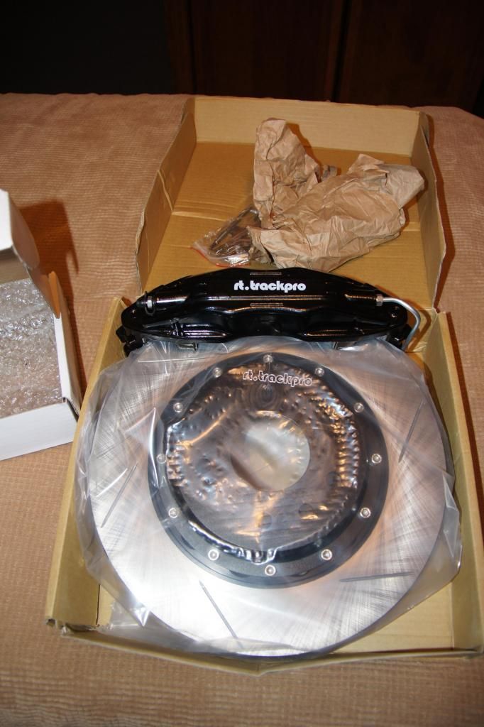

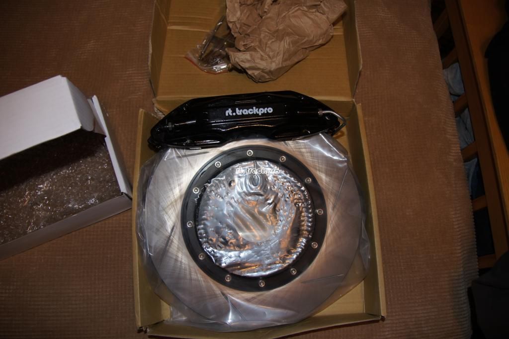

    Hopefully I'll have updates and fitment for these over the next few weeks. Need to set some time aside to go over and mount them up on the car.

    The brake pads that come with the kit are super meaty too.

    how does the quality of the kit look, 300?
  • 300zxturboftw
    300zxturboftw
    • 3709
    It's really well done. Everything seems pretty solid. Just have to test mount it on the car and then follow through on purchasing the wheels I want to run for a few months. Slap the expensive tires on and I'm good for the summer after an alignment.
