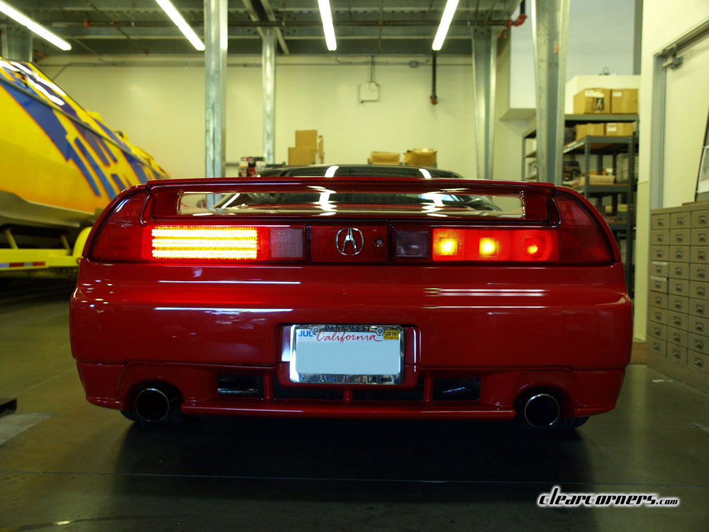

 I have been toying with a nice way to put LEDs into our tails. I personally don't like the circles. I thought of a design to look more like this \\ //////// But there are many ways to do it. I also adored the look of the BMW solid lined accent for the brake lights. I think that would be clean for an accent on the rear of our cars. After this led retrofit im doing on my buddies lexus, I may start moving on to the z if I can find some cheap as hell parts. Im really waiting to see those group buy ones to see how bright they really are.My Build Thread

 Don't like the the circles. Looks kinda meh. Much better if the whole assembly is filled with LEDs. Like so
