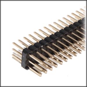

    I can just use something like this and jump 2 pigtails together I would assume?

    This seems like an option too. Obviously would have to figure out what the pin sizes are.

    Yeah you could totally use jumpers into the Z31 harness plugs and then pot them in place, as long as like you said, pin diameter is correct and makes a good contact.
