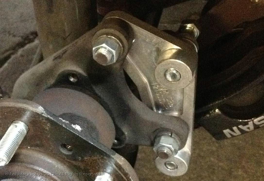

    Below are some photographs ..
    You don't have much room between the rotor and the caliper
    Check out the caliper re-location bracket .. beautiful eh?

    1- Will Z32 caliper's fit? Unfortunately I don't z32 caliper(s) … or they'd probably be on my Z now. Driven Authority did not have any spare calipers "on-hand" to test fit. The thoughts are that the Z32 caliper can fit - the only modificatoin that may be needed is to "grind" a little bit off the caliper to ensure rotor clearance.
    (I'm supposed to go back to DA next week for test fitting the z32 caliper)
    2- Driven Authority is looking into different options for this BBK.
    a) Using z32 calipers.
    b) Using a smaller 12" rotor (vs 12.19" .. which when the kit was developed, was the only one available)

    If he made the relocation bracket for the Z32 caliper I would buy this kit right away. I hope that he makes this kit for the Z32 caliper soon and im sure he would get lots of sales if he keeps the same price. Keep us posted on the progress the only reason I have not purchased is because I want to go with better calipers than stock.

    I really like the rotated relocation bracket, looks well made.

    cesar wrote: If he made the relocation bracket for the Z32 caliper I would buy this kit right away. I hope that he makes this kit for the Z32 caliper soon and im sure he would get lots of sales if he keeps the same price. Keep us posted on the progress the only reason I have not purchased is because I want to go with better calipers than stock.
    I don't see why you wouldn't be able to use a Z32 caliper the same way you use one on a stock Z31 setup…just put a washer between the caliper and the bracket.
    - VG30DET (HE341) 86 300ZX - 1982 280ZX Turbo - Headered NA 1986 300ZX 2+2 - 2000 Xterra -
    True, but it is all dependent on what the offset is on the rotor hat is on where it needs to be spaced.

    Yeah, but if they're designing it to be the proper placement of the caliper to the rotor with the stock Z31 calipers, then the difference would still be the same with the Z32 calipers, would it not?

    I think the amount of work required to put Z32 calipers on 87+ Turbo rotors the same way I myself and many others have done would be all that you would need to do to get the Z32 calipers to work with these brackets/rotors. All I did was bolt them on. lol. I didn't have to space them out. My calipers already had some washers integrated into them. Probably because I ordered 30mm and they gave me 26mm, so they knew what was up?
    I don't see how there would be any other mods required considering you're doing essentially the exact same thing. If the bracket repositions the Z31 caliper, it would do the same to the Z32 caliper, obviously.

    Just to be clear, a 30mm caliper will not clamp onto a 26mm rotor properly, you might get late engagement for the first 1/3 of pad life and then popping your dust seals
    Careless is using a matching rotor and caliper, it was the intermediate state they were designing stuff, notice z31/z32 rotors are still 280mm diameter?
    While z32 calipers in 26mm exist, I can't see people seeking those specifically, so if someone has z32 calipers, it's a very very good chance they are 30mm

    This is true. 26mm Z32 calipers are 90 NA only....they're the only one that will work with stock Z31 rotors, otherwise you need to use the Z32 30mm rotors.

    Ok .. This (I admit it) is what has confused me in that I was aware of different z32 calipers, I wasn't aware of what the differences were/are.
    My understanding .. Z32s use 11" rotors? With either the 26mm or 30mm caliper?
    This BBK is using a 12.19" rotor (looking at lowering the cost with a 12" rotor).
    Maybe the 26mm z32 caliper will be just a bolt-on (with or without spacers)?
    Maybe the 30mm z32 caliper will bolt-on (with or without spacer) and maybe (or not) some shaving on the leading/trailing edge? See there is very little clearance between the 12.19" rotor and the z31 caliper.
    As I said, the plains to test fit a z32 caliper on the 12.19" rotor setup with the DA bracket.
    I'll report on the test results .. Hopefully by the weekend (by this I meant "next" weekend .. Oct 6-7)
