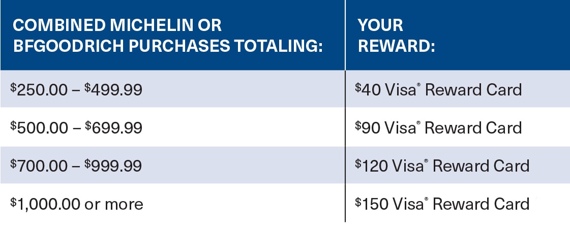

    FYI … I just bought new tires for the 5 lug project … Buying Michelin Pilots … notice the words "UP TO " in the rebate promotion … So 90 dollars discount ( over 500)
    But the Pilots I bought I got on sale … discontinued model .. y-rated …
    235/45ZR-17 Michelin Pilot Sport A/S 3+ (W- or Y-Speed Rated (Qty:4) $126.66
    https://www.tirerack.com/specialoffe…p?promoID=M041
    Get Up to $150 Back from Michelin? & BFGoodrich?
    Ends July 6 (5 Days Left!)
    For a limited time, bundle purchases of at least two new MICHELIN? or BFGoodrich? passenger or light truck tires and you can get up to a $150 Visa? Reward Card1 after online submission. You may also include select Michelin Motorcycle, Scooter and UTV tires, and select Michelin bicycle tires not sold by Tire Rack to reach any rebate level. Visit www.MichelinMan.com/promotion for a list of participating dealers. Offer valid on tires purchased from Tire Rack’s in-stock inventory between 12:00 a.m. EDT June 27, 2020 and 11:59 p.m. EDT July 6, 2020.
