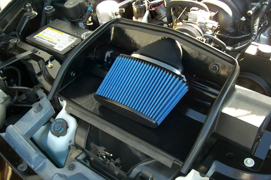

I guess then, by popular opinion--since it looks like it does, then it does.khyronzx wrote: Sure looks like it does to me and others agree. You didn't engineer and/or design it and I don't think you've done any wind tunnel testing on it either. Nor have you quoted or shown any evidence to support your opinion but you stated it such as being factual. Not trying to start anything.
This directs air:

It sits directly at the back of the hole in the hood for the scoop. Haven't looked at it in a while but that looks different iirc. I'm going to dig it out of storage when I go to get parts out after work.

The point I tried to make is that it's not sealing anything. Saying it "directs air to the turbo" is like saying that your hand "directs water to your mouth" when your fingers are spread apart.khyronzx wrote: It sits directly at the back of the hole in the hood for the scoop. Haven't looked at it in a while but that looks different iirc. I'm going to dig it out of storage when I go to get parts out after work.BLOZ UP.com

Got ya, but you can't deny removing it will affect where the air entering the engine compartment from the scoop opening goes.
