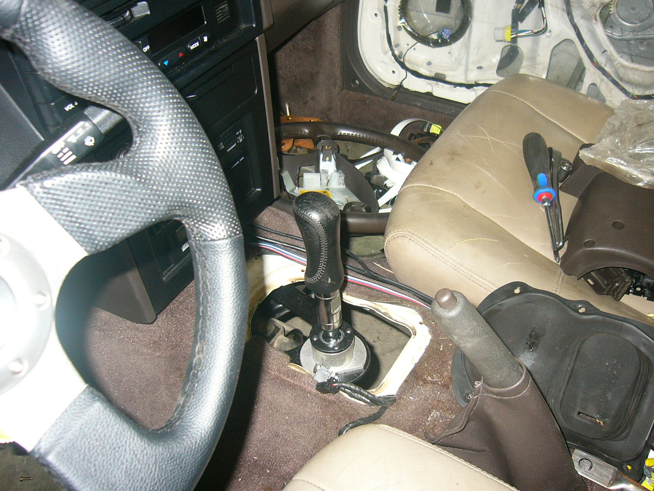

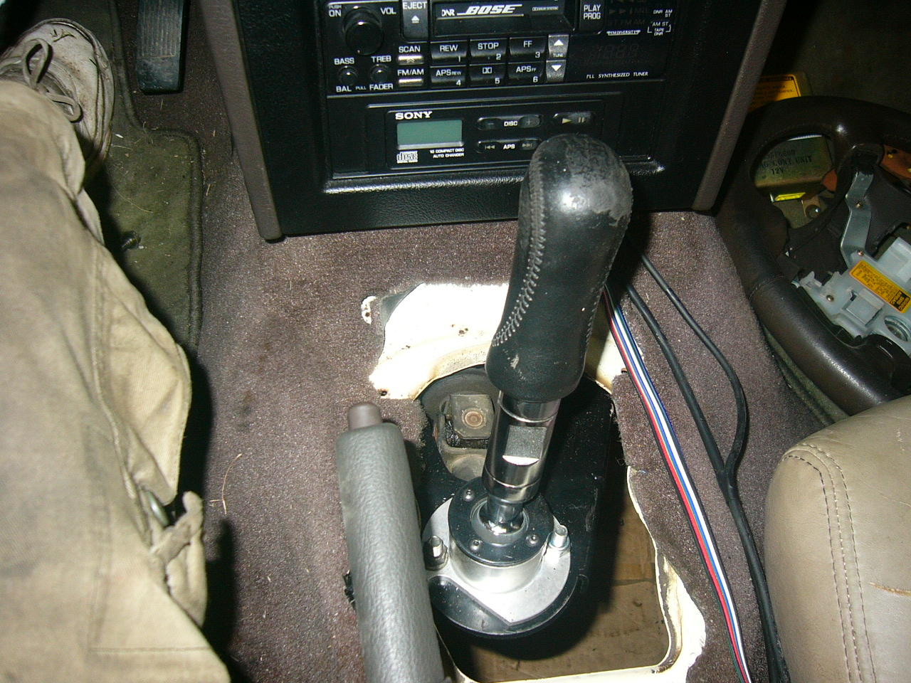

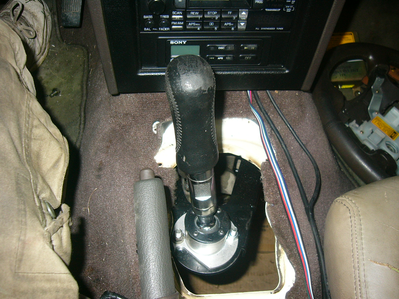

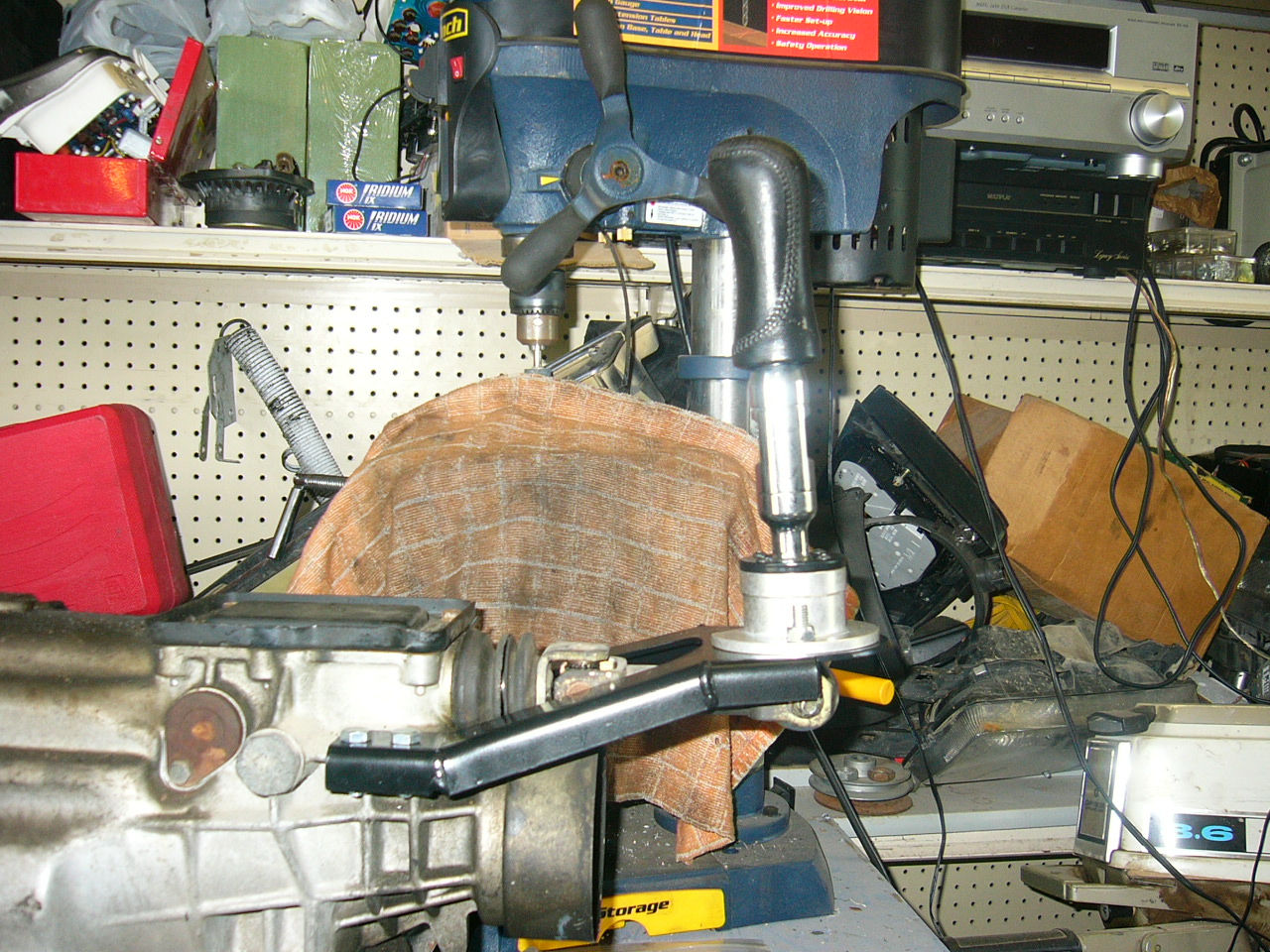

    Everything is bolted up. I'm going to throw a starter on tomorrow and make sure it engages properly… I don't really have any doubts that it will though. I have a bunch of pictures from a post on an M30 board, most of the stuff I got I would recommend in the Z31 as well so I'll copy it here:
    Alright.... here we go:

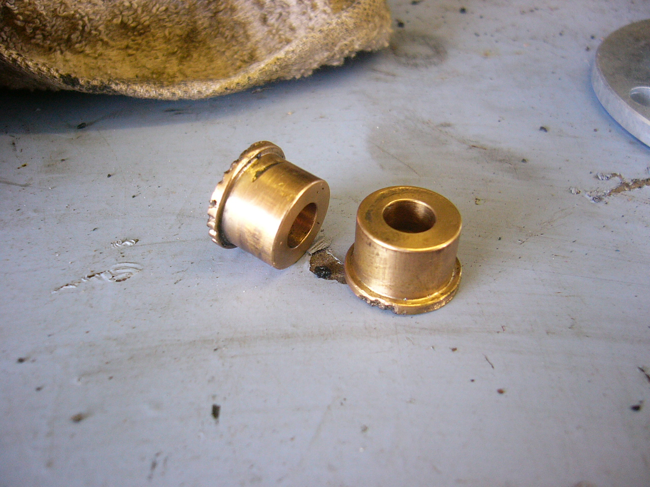

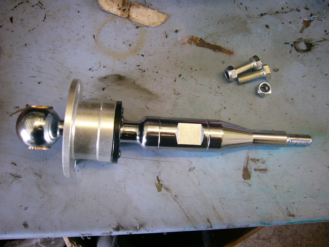

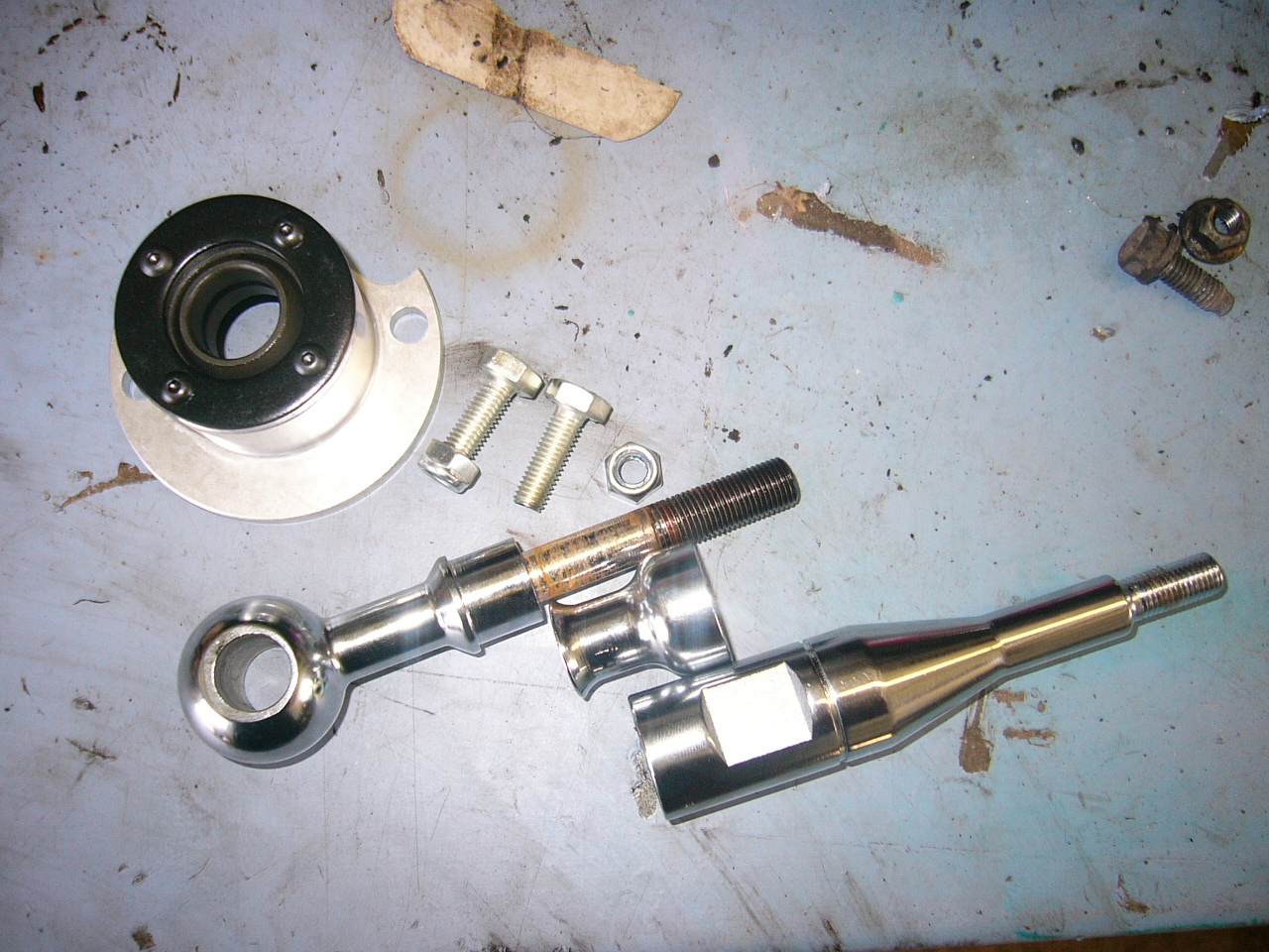

    Cheapo ebay short throw shifter. Did have to slightly file the inside of the hole to get the bushings in. The cheap shifters like this tend to be know for not having round holes… yeah, its weird. It did come with nyloc nuts, which was a very nice touch. I actually used one of the nuts for the shifter to linkage bolt so that I could tighten it somewhat loosely and not worry about the nut backing off. This makes for butter smooth shifting.
    SPL Parts brass shifter bushings… highly recommended. These got ate up a bit from when I removed them from my old shifter.

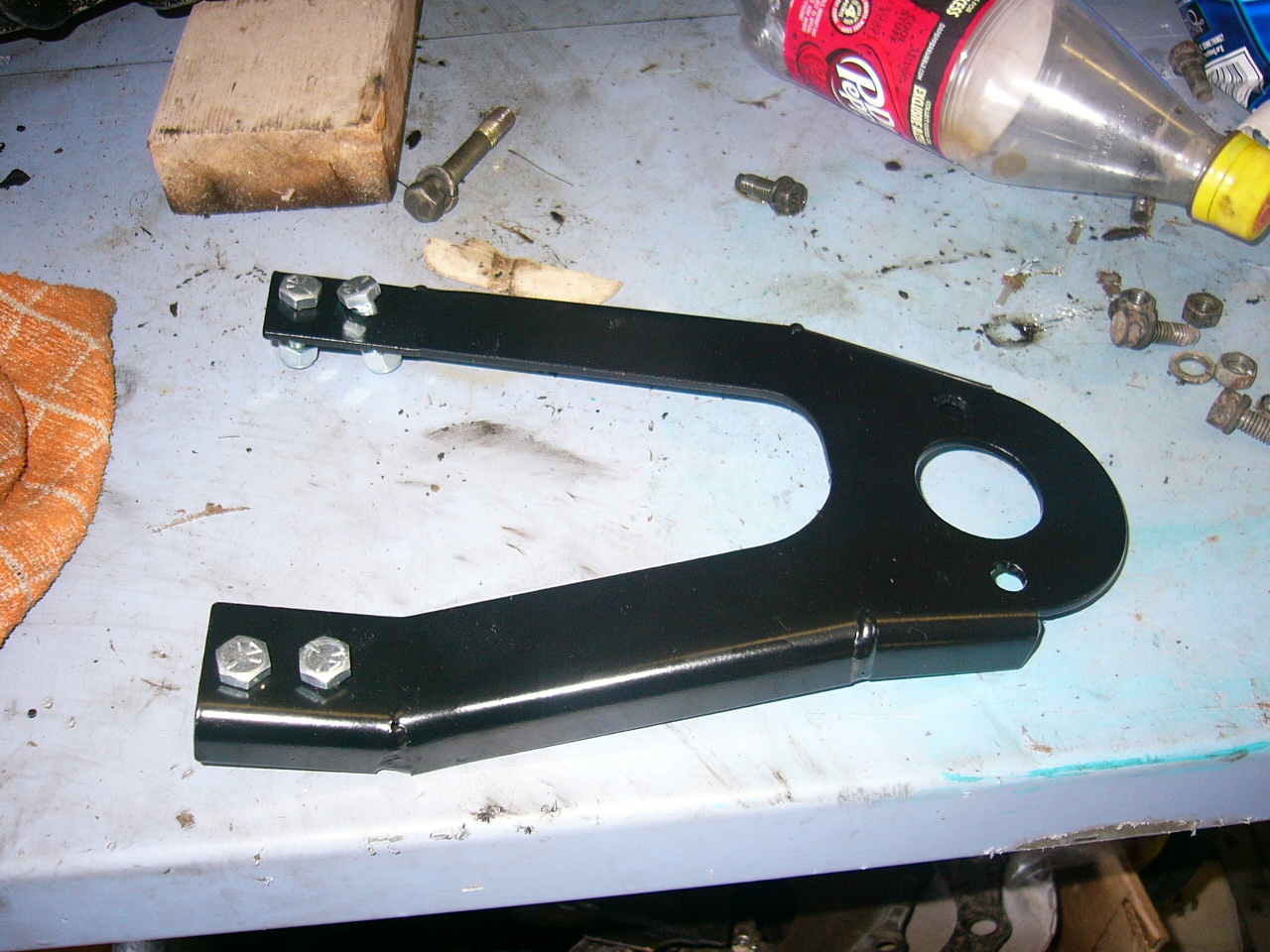

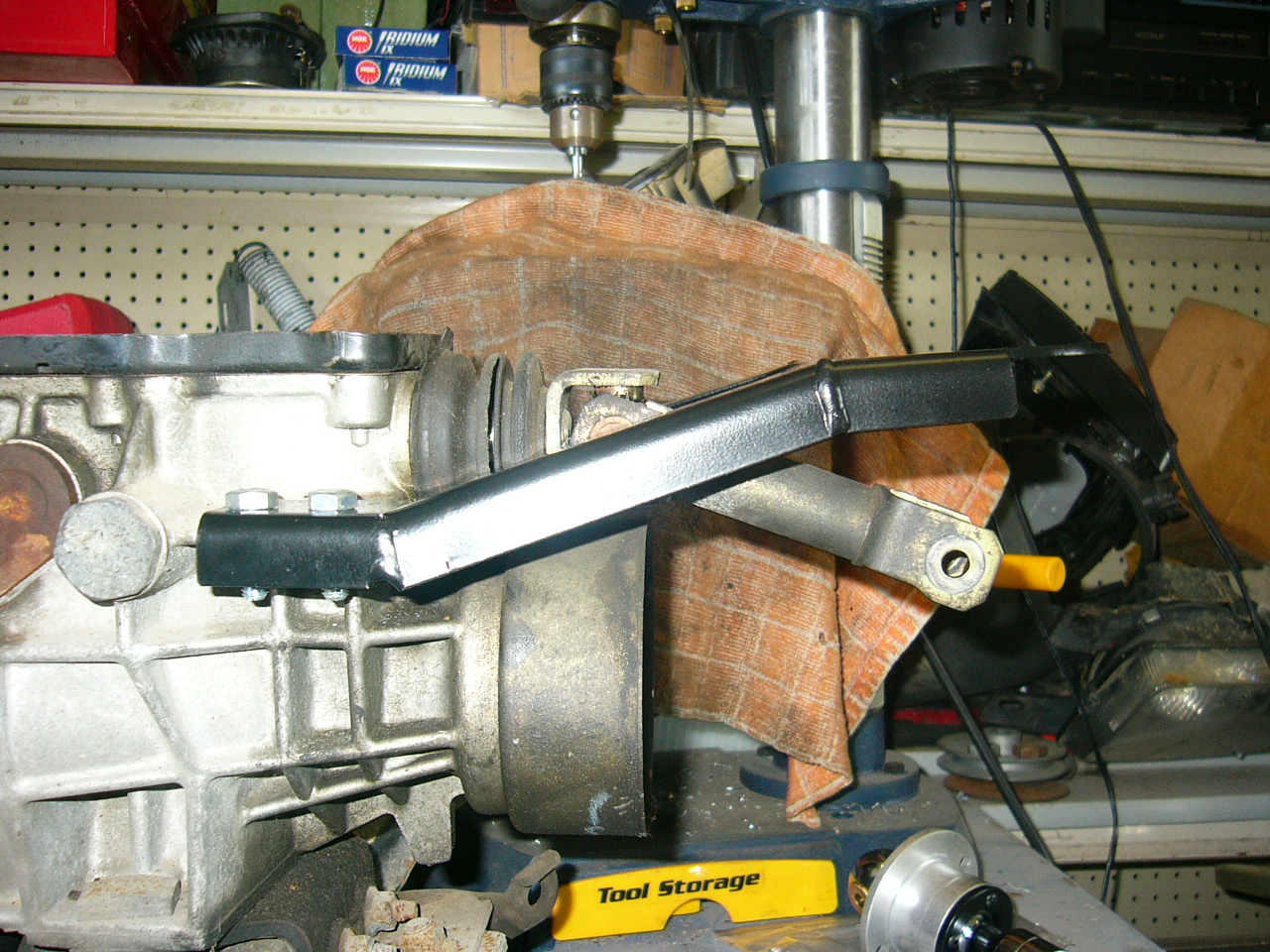

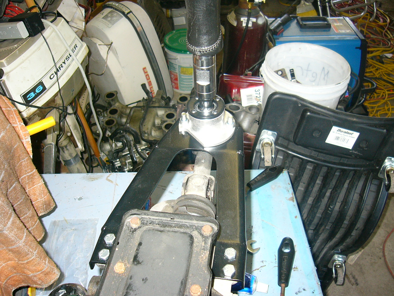

    Here's the solid shifter bracket. Like I said above, I love this thing. It feels so much better than the Z32's setup ever did, regardless of the STS. This one also includes nyloc nuts. I need to call Mazworx sometime as my particular bracket isn't parallel with itself. I'm not sure if that's how they design it or they just didn't get it welded up right. It could sit a little lower but it doesn't appear to affect the shifting in any bad way at all. As you can tell in these pictures… my garage is an absolute MESS. :lol:

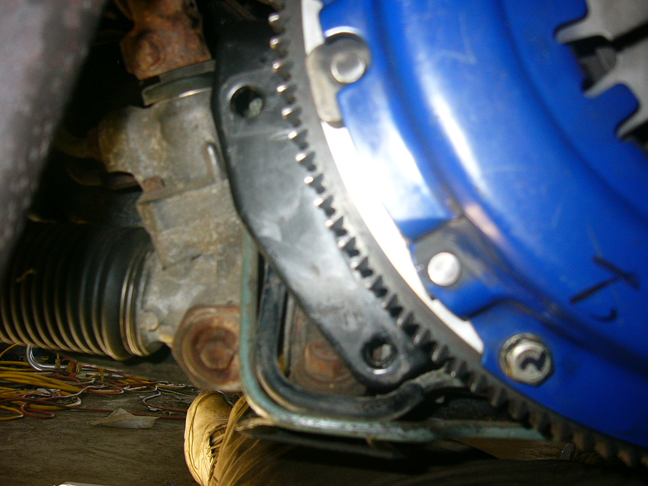

    89-91 Maxima SE Fidanza flywheel with Z31 Spec Stage 3 6-puck clutch (most definitely overkill, over over over over kill, but I had it laying around and didn't want to buy another clutch… probably should have though :lol: It will handle upwards of 515 ft. lb. torque.)
    I used the stock auto tranny metal covers/spacers that go between the engine and tranny, worked perfectly. One thing I did want to change was the brackets that the lower portion of the tranny bolts to. The auto tranny has threaded holes along the bottom whereas the 5-speed has a mix of threaded and bolt through (bracket has one hole and one hole with a nut welded on). The driver's side bolted up perfectly but for some reason the passenger's side Z32 bracket was some funky design and it wouldn't fit. Nothing to worry about though, just use a long bolt with a washer, lock washer, and a nut and you're good to go. This step is not required, just makes bolting the bottom on a tiny bit easier in my opinion. If you can get a Z32 driver's side bracket I'd definitely do it, if not just use some use a nut and bolt combo with lock washers. (sorry for the blurry picture)

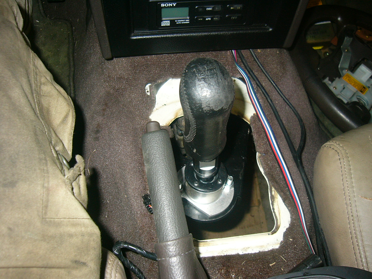

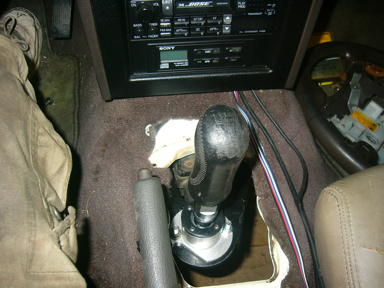

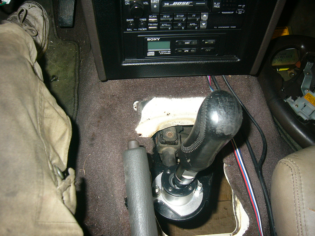

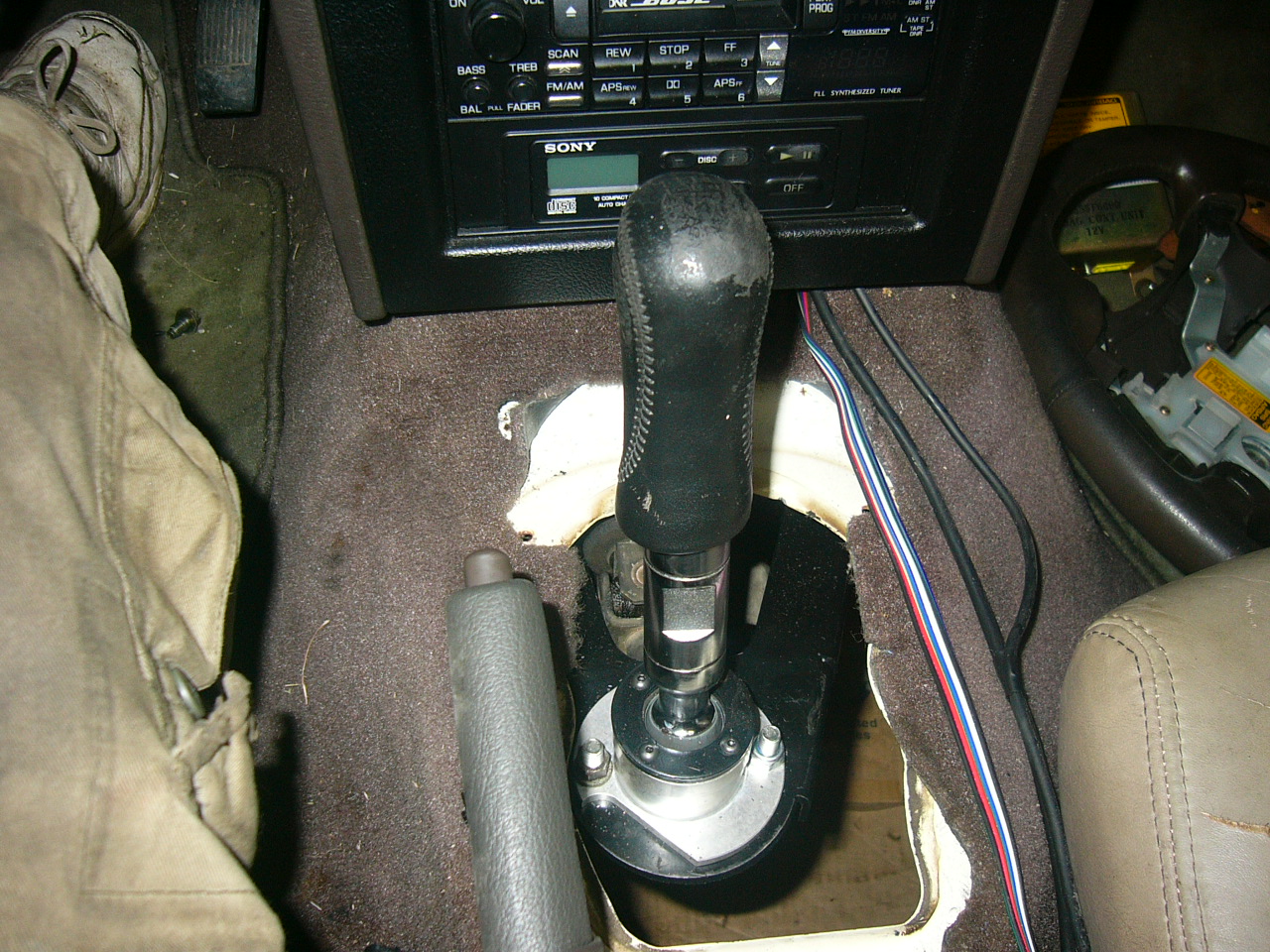

    And finally pictures of what it looks like inside. It appears to sit quite close to the driver's side but with the STS doesn't interfere with the hand brake and is actually quicker comfortable. Any further to the right and 5th would feel a bit far away to me (I believe this is mostly due to seating position, in the Z they have everything pretty close to you… if you sit in one or have sat in one I think you'll get what I mean :lol.

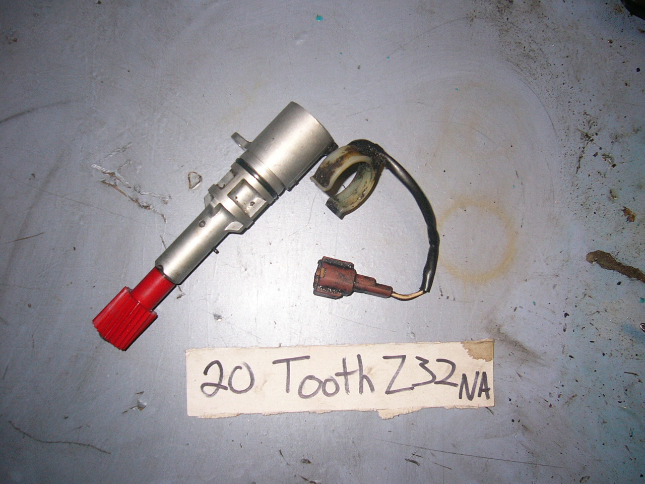

    This is something I wanted to ask about here though.
    Do any of you happen to have a picture of or happen to know if that is similar to the Z31 sensors? The M has a 3.92 differential and I'd like to use one of the 88-89 N.A. 19 tooth gears if it will work on this sensor.
