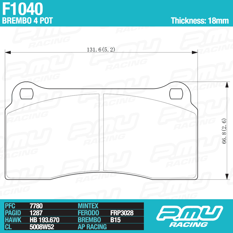

FYI: z31 87T and z32 calipers have almost identical piston area, having 4 pistons in a fixed caliper is the same as 2 in a floating caliper in regards to fluid vs travel
The calipers I'm sourcing are 8% bigger piston area, which shouldn't be a ridiculous stretch for the 15/16's master, so nobody panic haha
Here's a diagram of the pad and cross reference part numbers at the bottom courtesy of p-mu
